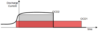

Hey Louis,
Thank you for your reply. Why OCD 1,2, and 3 is added if only OCD1 could do the job? Also if I enable all three OCD protections which one will take action, is there any priority setting among OCD1, 2, and 3 that I can set?
Hello Mohammed,
You could set different conditions with all of them, although they operate on the same principles. For each OCD you can set different minimum thresholds and a different time delay that is used to trigger the protection for the different current discharge protections. This is represented here (not-to-scale):
All of them are treated with the same authority.
