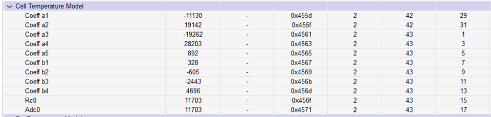

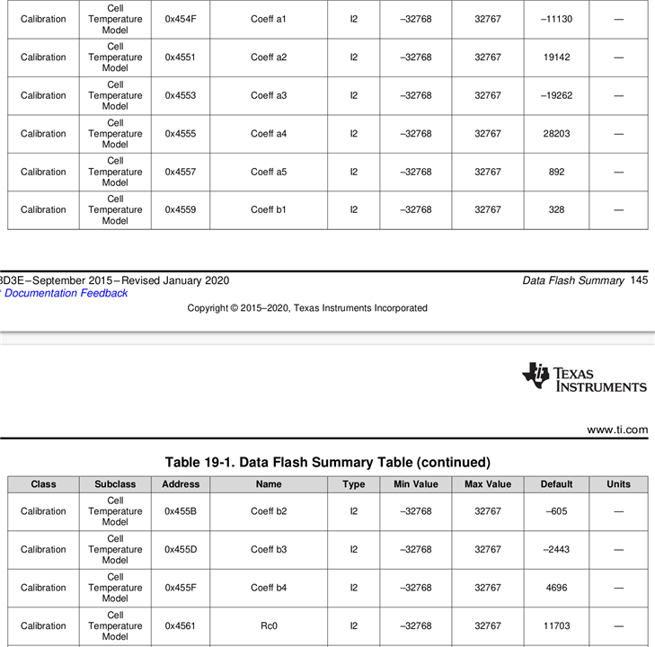

I am working on an updater for the BQ78350-R1A (updated to R2 firmware via BQ studio at manufacture time). SLUUBD3E Rev E (screenshot attached) claims that they start at 0x454F. However, reading from BQ studio (screenshot also attached) shows that they start at 0x455D. This is mirrored in the hex dump and csv files exported by the advanced views in BQ studio. So, which is correct?
