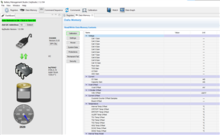

Greetings,
I have been able to successfully communicate/connect with both BQ76942 (I2C addr: 0x10) and BQ34Z100-G1 (I2C addr: 0xAA) via I2C using an EV2400 and BQstudio.
The problem I am currently facing is that I can only connect to the BQ76942 when the BQ34Z100-G1 is disconnected from the I2C bus. I can connect to the BQ34Z100-G1 when the BQ76942 is still connected to the same bus though.
The BMS board I am working with has both BQ chips on the same I2C bus, and the only way of disconnecting/reconnecting them is by desoldering/soldering 0-ohm 0402 links (this is currently the only method that works to connect BQstudio to the BQ76942).
When connected to the BQ34Z100-G1 I can use the 'Advancded Comm' tab to successfully send commands to the BQ76942 via I2C.
I have tried disabling 'Auto Detect at Launch' followed by manually selecting the BQ76942 to connect to, but the 'Auto Detected Device' still registers as '0100_0_16' which corresponds to the BQ34Z100-G1, and I get a warning dialogue saying that 'The selected device could not be found! [etc]' followed by the attached screenshot of the connection graphic. Interaction with the registers etc does not function correctly - it appears to be connecting to the BQ34Z100-G1 but trying to apply the BQ76942 register maps.
To clarify, I do not wish to connect to both simultaneously, I would simply like to select which chip to connect to for a single instance of BQstudio at startup.
Any assistance would be greatly appreciated!
