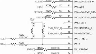

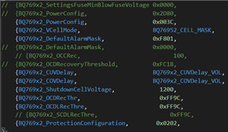

Hi Team,
When testing the 14S system, the cell voltage is about 3.53. When collecting Stack Volt, PACK Pin Volt, LD pin Volt, the voltage may be about 380V occasionally.
The temperature value may occasionally be collected to 3588K, and there is no abnormality in reading the data of the monomer. CRC is used during communication, and the CRC calibration is normal. Customer would like to know how to resolve this case?
