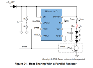

We got one question regarding Heat Sharing circuit.
Can we remove the BJT if PWM dimming is not required?
We also consider to seperate the TPS92611-Q1 PCB from the LED board. Is there any concern ?

1. Yes. If PWM dimming is not required, this can be removed. Just turn on PWM all the time.
2. Put a 10nF capacitor close to the OUT pin.
