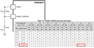

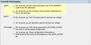

Dears,
I received TPS536C7 B1 chip then I remount to PCB, but when I check with GUI it changed address.
A0 => address 106d (current use)
B1 => address 93d
In my opinion A0 address should be 93d, but I read 106d, can you kindly find out reason?
