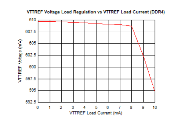

From this e2e thread, TPS51100 is able to used for DDR4 application so customer wants to use it for DDR4.
Customer wants to know the tolerance when Vref=0.600V, which means the deviation range from 0.6V.
Could you help with this question?
Thanks.
