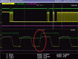

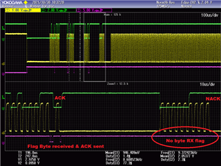

    I have  received new information (attached below) from client with the following notes:
    "I have a look deeper on the trouble and it seems come from my processor. In fact, just before stop to received data from the BQ76, my code ask for received next byte but the processor is generating 9 clock instead 8 and the I2C RX interrupt never trig (show screenshot). I add on the code an output drive showing waiting states. So, I must understand why the processor is on RX state but work as TX state (and really not working well because interrupt flag is not working include in TX state). Thanks you for your support. BR Thierry
    At the end, the problem is on the BQ76952. Is not fast enough for work at 400kHz. The processor is finding "P" conditions during transmission. See the last screenshot. The clock rising edge arrived before the slave (BQ) place the SDA. I solve the problem with 1k pull up on SDA and 10k pullup on clock for delayed this last one. Please, report this trouble and tell me any feedback."

  • Hi Archie,
    Some users have found 5k pullups work well. I have not heard of anyone needing to use different pullup resistors on SDA and SCL before and there is a very large number of users for this device. This seems a little strange. Perhaps it is unique to this specific board characteristics. Does their MCU support clock stretching?
    Matt
  • Hello Matt,
    Thanks for your support.
    The client responded that may be their trouble come from 2 ways. One is not using crystal clock on this project but the internal clock with pll (higher jitting than cristal clock). Second is that may be PIC18F processor have lower digital threshold and detect clock rising edge earlier than over components.
    The last screenshot attached show clearly that data edge arrive late regard clock edge. For that, they will keep different pullup value resistor on data and clock signals.
