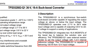

we found TPS552882 maxim output current value is confusing.
1. In the product selection list, the table shows the maxim output current value is 6.35A, as below image.
2. But the Average inductor current limit in datasheet is 16.5A typical.
3. and in the description "The TPS552882-Q1 is capable of delivering 100 W from 12-V input voltage."
4. and there are many efficience test figures, from figure 6-1 to figure 6-10, the maxim output current is less than 8A.
5. the webench says the thermal issue would occur, when the output current exceed 6A.
we need this part output 15A, when the input voltage is from 9 to 16, and the output voltage is 12V.
Could this part meet our design goal?

  • Hi Yao,
    TPS552882 has two different output limit protections: 1. Inductor average current limit, it is 16.5A typically. 2. Output average current limit, which is set by ISP, ISN pin. The maximum output current limit is 50mV/Rsense.
    Please always follow the datasheet.
    For your application, TPS552882 cannot output such a big output power. Please consider using the buck-boost controller.

  • Hi Yao,
    There are two limitations:
    1. TPS552882 inductor average current limit could be configured to maximum 16A typ, 14A min. The current limit tolerance should be took into consideration.
    2. If outputting 12V, 15A, 180W, the IC temperature rise would be extremely high and cause thermal shutdown.
    Please ignore the 30mV spec row. We will fix that typo. Thanks.
