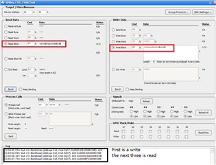

  • Hi
     Do they read back immediately?
    I would ask them to check the write and read waveform?
    Here is my test:
    Yihe

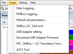

  • Hi
    It is hard to believe. but you can easily test. go to tool->clear configuration. the GUI will close afterwards, you can relaunch the gui to see how it works and then download their codes again.
    Yihe
  • Hi Yihe,
    Appreciate the help debugging this odd behavior. Is "refresh all parameters" the same?
    Also would this be good for customer to do? clear the configuration, and then reload their configuration?
    Thank you,
    Delaney
