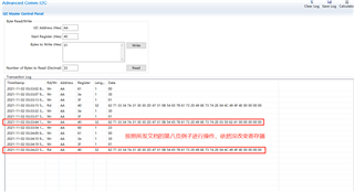

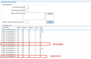

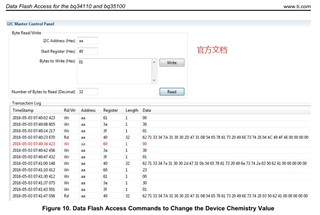

Use the iic communication under advanced comm in bqstudio to change the register values as described on page 20-21 in the BQ34Z100-G1 Technical Reference Manual file. And finds the following questions:
1. Is this value written to 0x40 or 0x4b,  theoretically it would be written to 0x40:
2. (whether written to 0x40, 0x4b) Read and write to file, and after step 10, read out the register to be written and change back to the original value:
The data is as follows:
Could you please help check this case?
Thanks!
