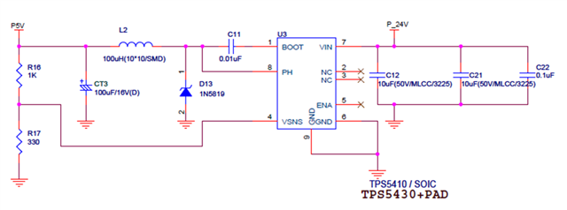

 4. It is schematic of our customer.
     When I checked, there is no problem.
     Could you please double check?

  • Hello
    I don't see any issue with the schematic.
    With the 9.1k resistor your total error spread is only 2.4%.
    With the 1k resistor you total error spread is only 0.8%
    These are both much less than the ensured specification of 4% for the reference alone.
    Keep in mind that the ensured specification is for the reference voltage only; not the output voltage.
    The block diagram of the TPS5410 shows some internal impedance connected to the VSNS input.
    This is probably causing some small current to flow in the feedback resistors, causing the small error difference.
    The second line in the EC table for the reference voltage is valid for -40C to 125C.
    Unless the customer is OK with at least a 4% total error in output voltage, they will not be able to use a voltage
    regulator as a precision reference for a DAC.

  • Hello
    Yes it is OK with 1k.
    It is +/1 2% or a total of 4%.
