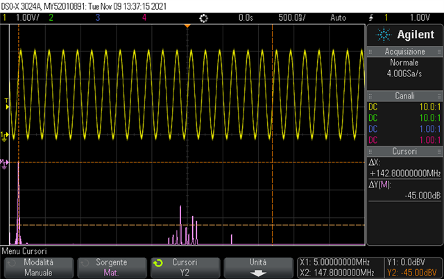

    In the meantime, I have done some measurements, and there seems another issue. That is, sort of feedback from OUTH, OUTL outputs to the IN+ input. I will show you the obtained waveform using DSO- X 3024A oscilloscope and N2863B probes, and the alligator ground (I think this should be revised in the next version but here I just show what I have obtained). BTW: All these readings are done just at IN+, and the schematic of the built circuit is shown below this message.
    1. Using a sine signal at IN+ f= 5 MHz, 0-3 v, the time and frequency (FFT) analysis of the signal is shown in Scope_22a screenshot at IN+ of LMG1020 with LMG1020 disconnected from DC supply. As I connect the DC supply, the signal is shown in Scope_22b appears. You can see there is a lot of harmonics (though power-wise they are about -40 dB less, they are strong enough to distort the time domain signal). Given FFT analysis done with 200 MHZ span and 100 MHz-centred screen.
    2. At 5 MHz the time domain signal does not look to be a pure sine at IN+, and there are some “imperfections” as shown in scope_23 when the LMG1020 is on. The amount of these imperfections are quantified using the oscilloscope FFT analysis as shown Scope_22a,b.
    3. Using a sine signal at IN+ f= 30 MHz, 0-3 v, the time and frequency (FFT) analysis of the signal is shown in Scope_24a screenshot at IN+ of LMG1020 with LMG1020 disconnected from DC supply. As I connect the DC supply, the signal is shown in Scope_24b appears.
    4. At 30 MHz the “imperfections” seem to be more powerful as shown in scope_25 when the LMG1020 is on. The amount of these imperfections are quantified using the oscilloscope FFT analysis the same way as before.
    The question is: is there an indication whether the feedback can be avoided/minimised, how can I quantify it, best practices in the layout stage to suppress it, etc.

  • Hi Mark,
    Did you mean to attach several images? I can only see image 22a.
    Leslie

  • Hi Mark,
    I'm a little confused by what you are trying to do here with a sine wave at the input. The driver is design to have a square PWM signal at the input typically from a controller, and that PWM signal defines the ON/OFF state of the driver's output. Typical this PWM signal is driven at only 2 levels: 0V or below VIL to turn OFF the FET and 5V or above VIH to turn ON the FET:
