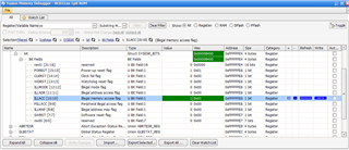

  • Hi Ian,
     - Thanks for the suggestion.
     - I changed zoiw_size to 500 and actually triggered an illegal memory access (screenshot below). However, which exception would be trigger in this case? Because I still didn't see DEBUG_PIN toggle.
    Or
     - How can I trigger the 3 exceptions? So that I can make sure DEBUG_PIN will be working next time I encounter an exception.
    Ps. The 3 exception handlers are coded below. Is it ok to you?

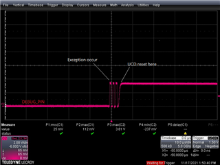

    ** Update 2021/11/17 **
     - I am sorry. I think it is the for-loop of "nop" that cause ROM mode failure and the missing of DEBUG_PIN toggle.
     - After removing the for loop, leave only DEBUG_PIN toggle. It works fine now. I can see DEBUG_PIN toggle very clearly, and everything works fine.
     - Screen shot below.
    Exception handler:
    #pragma INTERRUPT(abort_data_fetch_exceptionDABT)
    void abort_data_fetch_exception(void)
          DEBUG_PIN = !DEBUG_PIN;
        SysRegs.SYSECR.bit.RESET = 2;  // SOfrw
  • Great.  I'll close this thread, and you can test to see if you still get your situation with the background loop crashed and the timer interrupt still running.  If it happens, please start another thread.  I don't expect it to happen.
