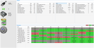

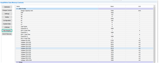

I get Gas Gauging parameter using learning cycles  and online GPCChem tool.
"Gas Gauging","CEDV Profile","Design Capacity mAh","7200","mAh"
"Gas Gauging","CEDV Profile","EMF","1942","-"
"Gas Gauging","CEDV Profile","C0","153","-"
"Gas Gauging","CEDV Profile","R0","77","-"
"Gas Gauging","CEDV Profile","T0","3500","-"
"Gas Gauging","CEDV Profile","R1","248","-"
"Gas Gauging","CEDV Profile","TC","11","-"
"Gas Gauging","CEDV Profile","C1","0","-"
"Gas Gauging","CEDV Profile","Age Factor","0","-"
"Gas Gauging","CEDV Profile","Fixed EDV 0","1800","-"
"Gas Gauging","CEDV Profile","EDV 0 Hold Time","1","s"
"Gas Gauging","CEDV Profile","Fixed EDV 1","1885","-"
"Gas Gauging","CEDV Profile","EDV 1 Hold Time","1","s"
"Gas Gauging","CEDV Profile","Fixed EDV 2","1900","-"
"Gas Gauging","CEDV Profile","EDV 2 Hold Time","1","s"
"Gas Gauging","CEDV Profile","Voltage 0% DOD","2100","mV"
"Gas Gauging","CEDV Profile","Voltage 10% DOD","2072","mV"
"Gas Gauging","CEDV Profile","Voltage 20% DOD","2054","mV"
"Gas Gauging","CEDV Profile","Voltage 30% DOD","2038","mV"
"Gas Gauging","CEDV Profile","Voltage 40% DOD","2018","mV"
"Gas Gauging","CEDV Profile","Voltage 50% DOD","1999","mV"
"Gas Gauging","CEDV Profile","Voltage 60% DOD","1978","mV"
"Gas Gauging","CEDV Profile","Voltage 70% DOD","1954","mV"
"Gas Gauging","CEDV Profile","Voltage 80% DOD","1925","mV"
"Gas Gauging","CEDV Profile","Voltage 90% DOD","1885","mV"
"Gas Gauging","CEDV Profile","Voltage 100% DOD","1800","mV"
And now i want to make Qualified discharge for updating FCC, now my FCC value is 2712
The Design capacity of battery is 7200mah. I full charge my  battery and  apply the constant current load with 1100ma value, but VDQ bit in OPERATION STATUS does not go HIGH. What i do wrong?

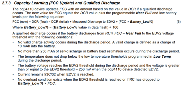

  • Hello Andrey,
    The discharge should be at least 3C/32, for your case that's around 700mA for the discharge to qualify for FCC learning.

  • Hello Andrey,
    If the VDQ bit is going low, one of the conditions for a qualified FCC update is being violated:

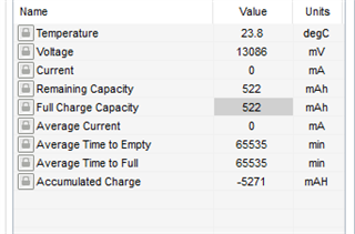

  • Thank you for reply. What FCC value mean? Last updated  FCC? Now in BMS studio it is 522mah and it is very wrong value. Capacity specified by manufacturer on battery is 7200 mah. My electronic load measure 7400 mah capacity with discharge current 200 ma (0.03c) but in BM studio value updated from 2700 mah to 522 mah after discharge process. How often fcc updated throughout qualified discharge process? I attach in prev message discharge log and gg file before and after discharge process

  • Thank you, Wyatt. I attach yesterday discharge log. When voltage reaches EDV2 level VDQ bit become 0 rows (5580 - 5581). FCC capacity did not updated after this rpcoess and renail 522 mah. It is very wrong value

    2. What does iy mean " The battery voltage reaches the EDV2 threshold during the discharge period and the voltage is greater
    than or equal to the EDV2 threshold – 256 mV when the bq34110 device detected EDV2" ?  1859 (my EDV2) - 256 = 1603

  • Hello Andrey,
    I'm not sure how the SC bit was set but it will divide the counter so the gauge thinks there's much less current passed. The DCR is not visible, but it is a pretty good indication of what it's at when the FCC updates. IF you enable the SC bit again you should see FCC decrease. FCC can only increase a certain amount during each cycle.
    The condition you're referring to is meant to filter out large voltage drops from being counted, so if your voltage dropped from a large load past EDV2-256mV it will not qualify for learning because the load is so large near the EDV point.
