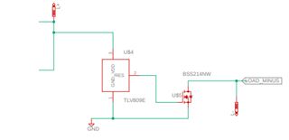

Hi all,
I have a simple circuit with an issue.
The design is simple.
We have an input voltage of 2 to 4V and a TLV809EA29DCKR supervisor with push-pull output.
The output is directly connected to the gate of a FET, BSS214NWH6327XTSA1.
The problem is when I change the input voltage slowly from 2V to above above the threshold of the TLV (around 3V), the output of the TLV stays low (0.00V) and the FET won't switch.
I see the current pulsing with around 80uA every 200ms, so I assume the internal timer is trying to switch the output stage to high.
When I disconnect the gate of the FET, the TLV works fine.
When I connect the FET, the output of the TLV stays low.
What goes wrong?
ps. I've changed FETs and TLV's but it stays the same. Nothing is defect.
I've also tried a gate resistor if 47kOhm, but the output of the TLV stays low.
The output of the TLV goes finally high if I up the input voltage to 4.8V.
  • Hi Bart,
    Can you add a cap on the VDD on the TLV809E and try these tests again?
  • Hi Marcoo,
    That must be it.
    Off course the FET switches something and the source of this current is also coming from the same source.
    Assuming my power source is ideal is a big mistake.
    The input has a little 4.7ųF capacitor but this might be too small.
    I will take out my oscilloscope and look for proof.
    The hickup of the input current is a giveaway.
    When the TLV wants to switch on the voltage on the input drops again by the switched load. And so it keeps on triggering the output every 200ms for a very short period.
    Learning every day.
    Thanks for the hint.GrinningThumbsup
  • I've added 50uF to the source and increased the source drive strength to 250mA. The chip workes fine!
