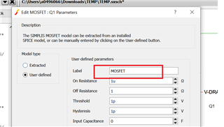

  • Hi, Craig:
    I think you missed to input the MOSFET label as below.
    There is no error message after I key it in. Please check the attachment.
    Thanks.
     https://e2e.ti.com/cfs-file/__key/communityserver-discussions-components-files/196/1_5F00_PRI_5F00_AUX_5F00_NO_5F00_Cntrls.sxsch
