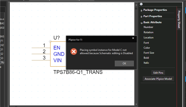

I have been trying to simulate TPS7B86-Q1 model in pspice. I used the transient model given in the TI website for the simulation. As i import the part in pspice, i am not able to add anything to the part as it says 'Schematic editing disabled'. Could someoone please help me to figure out what the problem here is? I have attached a screenshot of the problem to this email.

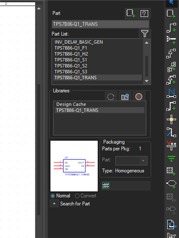

    In the screenshot you attached it looks like you are in the symbol editor. To be able to place the part you will need to do a couple things. First, right-click on the Library folder on the left tab, click Add File, and select the TPS7B86-Q1_TRANS.OLB file from the downloaded .zip file.
    Then, you will need to create a simulation profile (if there isn't already one) for the schematic you are working with. Go to Pspice -> Edit Simulation Profile -> Configuration Files -> Library. Click Browse and find the TPS7B86-Q1_TRANS.lib file from the downloaded .zip file. Then make sure you click Add to Design before closing the window.
    The TPS7B86-Q1 library should now be available in the Place Part menu on the right.
