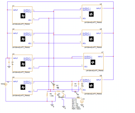

We are trying to design a voltage regulator, and we need an output of 2A from each one of the LM1084 regulators that are present in our circuit (I wasn't able to upload the .opj file so I'm attaching a screenshot).
I'm unable to define a 0.5 OHM load at the output. After running the simulation, I receive the following error:" Less than 2 connections at node GND".
 we need to verify the output current (2A from each output rail) with the simulation, can you please assist?

  • Hi Anna,
    This error is normally caused by a net that has only a single connection, but I don't see an obvious reason why you are getting this error.
    Besides the PSPICE error, what you are trying to do here will not work in a real application as-is. You cannot directly connect the output of LDOs together as you have done because of the inherent differences between the devices, but you can connect them together if you use a ballast resistor at the output of each. Here's a reference design that goes over the design of such a circuit:

  • Thank you Nick, Is it possible to send you the simulation file ? It seems that the problematic node is the connection to ground of R1 and C2, because when I cut out the load part, it works. I can't figure out how to connect the load without getting an error.

  • Hi Anna,
    Now that I think about it, I believe LM1084 is not a good device for this paralleling idea for a couple reasons. The main reason is that the document we have that describes how to parallel LDOs assumes the use of a device that has an NR/SS pin so that the internal references can be connected, which eliminates errors associated with inherent reference voltage differences between devices. This brings another issue with it, which is that we do not have equations for calculating the size of the ballast resistors when this extra error source is present.
    I've looked around and the part that best fits what you are trying to do is TPS7A47, but it is only a 1A part, so you would need to parallel twice as many of them. Unfortunately getting large currents with a high input and output voltage is a difficult thing to do so our portfolio is relatively limited for devices like this.
