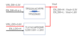

(2)I will design power mux circuits with TPS22963C and TLV74218.
Vout is selected 3.3V or 1.8V by EN_SW.
When EN_SW change L to H, does TPS22963 output 3.3V normally?
(Can TPS22963 change current protection mode to normal operation ?)

    Condition is followings.
    Cin=47uF x2 (=12V to 3.3V DCDC's Cout)
    Cout=1uF+2.2uF
    Rout=33 ohm (max 100mA)
    Ta = 0 ~ 70℃
    I need to satisfy "slew rate < 18mV/us" in rising.
    (0V to 3.3V Rise time must be longer than 183.33us.)
    datasheet tR Typ: 715us > 183.33us . It is OK.
    I want to know tR Min > 183.33us satisfy or not.

  • Hi, thank you for your support.
    How about (2) question?
    Do you think TPS22963C operate normally?
    (3.3V output and 1.8V output are cotrolled by EN_SW on my shcematic.)
    Best Regards.
    Alternative to our integrated power mux products, with regard to power muxing solutions, we recommend two load switch devices that have reverse current blocking and no quick output discharge.
    The EN signal used for one device will pass through a inverter and then is used to control the second device.
    Alternatively another method of control is to use a MCU with two outputs and tuns on/off one device waits, for a slight delay and then turns on/off the second device to avoid any channel to channel conduction.
    In load switch muxing, you use the reverse current protection to turn off the device during switching.
    Without reverse current protection which does not appear present in the LDO device, reverse current has the potential to flow through the body diode of your LDO whenever the output is greater than the input such as in which can cause damage explained further in this E2E blog:
    https://e2e.ti.com/blogs_/b/powerhouse/posts/ldo-basics-preventing-reverse-current-in-ldos
    With output discharge present in the LDO, if using the 'P' part, the output will discharge whenever EN is low for the TLV74218P device even if the TPS22963C is sending out an output such as in case 2. This will cause a huge power loss on TLV74218P.
    In a powerMUX however, there is a seperate switching circuit that handles these cases and protects against the backflow of current by waiting for the output to drop below the input before turning on the channel.

  • Hello, thank you for your reply.
    We used TPS22914C and TLV74218 for Power MUX on our past product.
    However, I need to change TPS22914C, because 0.4mm pin pitch is not good for our next product.
    So, I think changing TPS22914C to TPS22963C.
    TPS22963C is 0.5mm pitch, and its rise time (=tR) is OK (>183.33us).
    I want to change TPS22914C to other load switch simply.
    Could you let me know my (2) question?
    I want to know TPS22963C operates nomally or not.
    Best Regards.
  • Hello Yama,
    TPS22963C when disabled will keep reverse current flow less than 0.02uA. Using this device to mux will be fine as long as you've confirmed your timing requirements; however, I can't speak for the TLV device operation. You will have constant power loss due to QOD functionality of the TLV device when 63C device is powering the load.

  • Hi Yama,
    Thank you for your patience. Design has deduced the given condition should meet your customer's requirement of tR > 183.33us.
    Based on simulation data, we would expect the rise time to behave as below:
    TPS22963C tR
    Conditions  Rise Time tR
    Rout Cout min  typ max
    10ohm 0.1uF 447us 800us 1.30ms
    33ohm 3.2uF  402us  729us 1.20ms
    Do note, these values are not guaranteed by TI as they are not in the datasheet. These values should serve as a design reference only.
    However these should provide some comfort since the minimum rise time simulated is still much greater than the system requirement of > 183.33us.
