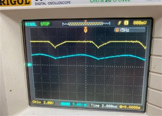

voltage at output diode:
in other scale:
and voltages input (blue) and VLIN (yellow):
Input voltage goes below 5 V and current limited to about 0,7 A.
We testing the 3.3 V output for now because the first ouput of the device (5 V) is broken. We have three devices LM2642 with broken first output for now under the same situations: as power input goes low (or load goes high enough), ULVO mode is on for some time (about 30s - 2m) and then 0V forever at this output not depending how much power we have at the input.
Questions for case 2 are: 1) Does input voltage (below 5 V) in ULVO mode appears to be normal? 2) Why does the first output fail after some time of ULVO mode?

  • Case 1: Yes, the efficiency of 87% is expected at 24Vin. As you can see from Figure 21, it is close to what we also measured at 22Vin (as shown below). You will see an efficiency drop at a higher input voltage due to higher switching losses, etc.
    Case 2: Does the 5V output work at higher Vin (e.g., at 24Vin) or if you increase the input supply current? It is difficult to read the schematic because of the resolution. Still, assuming you have done the calculation correctly according to the datasheet, your PCB layout and the bill of materials are the next things to look at.
  • Unfortunately 5V output didn't work in our experiment because it was broken earlier. 3.3V output starts working when we increase input supply current (given input voltage set to 24 V but because of small current set in power source it's about 5 V). At some level of input current LM2642 exits from ULVO mode and the input voltage become normal 24 V.
    I've included BOM as well as schematics & pcb layout.

  • Thank you for the information. 1200uF for the output capacitor seems excessive. If the output capacitor is too large, it will take longer for the output voltage to reach regulation. The under-voltage protection gets initiated if the output voltage is still below the regulation limit before the soft-start timeout.  Please remove the 1200uF and see if the problem goes away.
  • When we removed this 1200 uF capasitor and leave only 2.2 uF at the 5V output (1st one) the IC went to the overvoltage protection mode as we supppose and switched off both output channels by opening bottom FETs. When we returned back this capasitor the LM2642 works correctly. We continue studying an IC behaviour in our scheme.
  • If reducing the output capacitor is not viable, another suggestion is to increase the soft start cap. This will help limit the inrush current and also gives more time for the VOUT to reach regulation before the soft start timeout, therefore preventing any false triggering of the current limit or UV protection.
