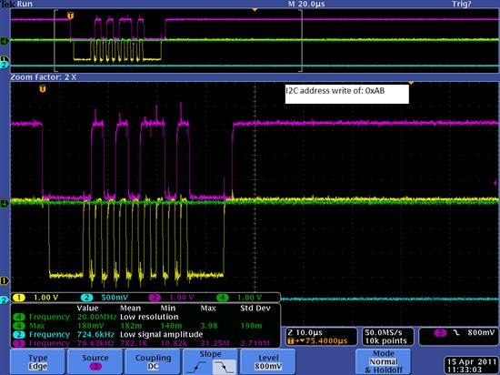

  • 1.  This testing is being done on a custom board.  Here is the schematic:

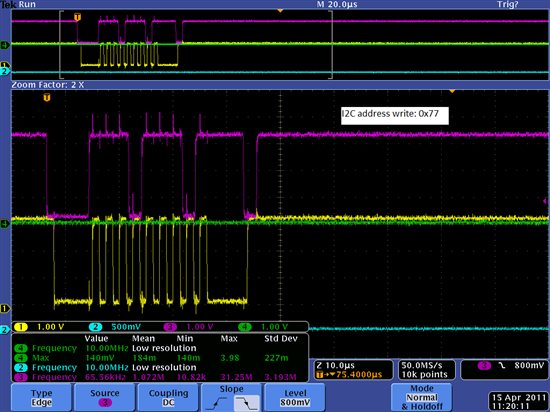

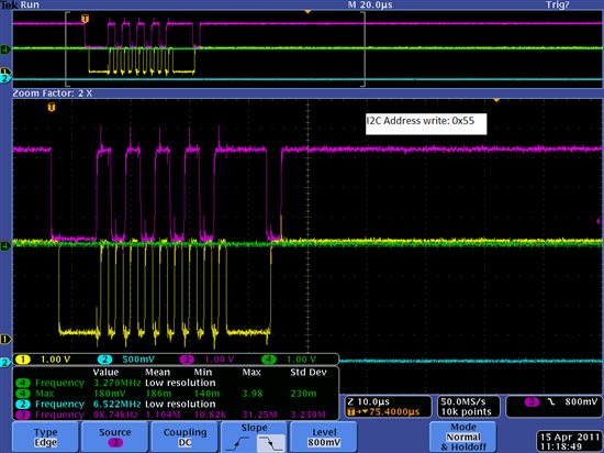

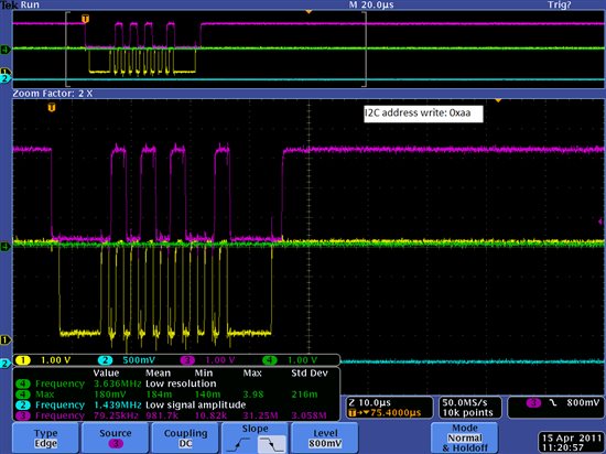

    3.  Yes.  Here are scope images of writes to 4 different addresses.  0x55, 0x77, 0xAA, 0xAB:

  • Yes, the problem persisted even after swapping out the chip.  Every pin was behaving correctly and the levels were all within spec, I just hadn't seen any response on the I2C.  On a lark, one of the software engineers mentioned if I'd tried a slower data rate.  I said that I had...I thought.  Turns out that if I turn the data rate down to 100KHz then I get responses from the chip.
    I haven't looked carefully since finding that out, but I don't recall reading that in the datasheet.  400KHz is such a standard that I'm surprised I had to go to 100KHz.  But anyway, at least we can yell at it and it yells something back.
