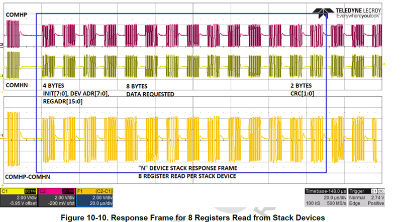

The data sheet lists the max min voltages of the COMLP, COMLN, COMHP and COMHN signals as +/-20V. To probe these signals, what do you recommend as a level translator, differential to single ended converter?
