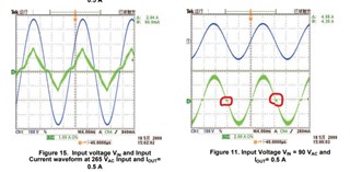

My customer asks one question. they want to refer SLUA517 to design their project
Can the THD of this current waveform be improved? thx

Hi Jimmy,
you can refer this application note at section6 , you can add some offset at CS pin to reduce the noise.
