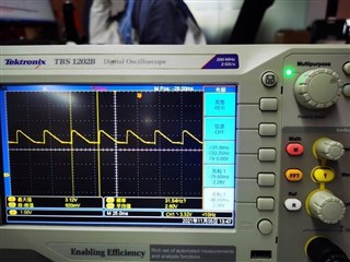

The waveform was normal when output 3.7V. Now the customer wants to output 4.3 V, and the waveform is abnormal.

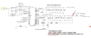

1. Initial design(normal):
Input voltage 5V, switch frequency setting 745KHz, output voltage 3.7V .
VOUT=Vref*((R208+R211+R209)/R209)=1.1* ((23.7K+0.02K+10K) /10K) = 3.7 V;
Input voltage 12V, switching frequency setting 745KHz, output voltage 3.7V.
2, Change Design(abnormal):
Input voltage 5V, switching frequency setting of 745KHz, expected output voltage 4.3V, but the voltage is like the wave 1 below( The test points are shown by the red arrows in the schematic), the inductance whistles.
VOUT=Vref*((R208+R211+R209)/R209)=1.1* ((26.1K+3.3K+10K)/10K))=4.3V;
Below is the schematic, could you please help give some suggestions? Thank you!

    The second design is most likely bumping into the minimum off-time specification for the the TPS543B20. The typical spec for the minimum off time is 250ns. Without factoring in the DCR of the inductor, I calculated the minimum off time of the 5Vin to 4.3Vout design to be approximately 178ns, which is beyond the limitations of this controller.
    In order to combat this, I would recommend reducing the switching frequency and increasing the inductance if possible. This will increase the switching period such that the controller may meet its minimum off-time requirement and increasing the inductance can help reduce the inductor ripple current increase that comes with a switching frequency reduction.
