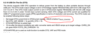

    Can I use the BQ25723 device in OTG mode, supplying a voltage on Vbus example + 11.8Vdc, shared with a + 12.0Vdc power supply?
    To better explain: the external power supply at + 12.0Vdc is the primary voltage on Vbus, in the absence of + 12.0Vdc, the BQ25723 inserts an OTG voltage of 11.8VdC on the Vbus to keep the external devices connected to the Vbus alive.
    Thanks Peng for your help.
    Enrico Gatti
  • Hi Enrico,
    No, not at the same time. VBUS needs to be below Vvbus_convenz for OTG mode.
    Also, it is never a good idea to tie 2 power supply outputs directly together.
    You may need external circuits such as a diode Or-ing IC (but this may make charging implementation a bit more complicated). Or wait until the 12 VDC is gone before enabling OTG.
