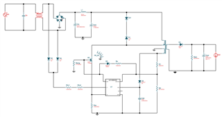

I've made a flyback schematic with the UCC28633.
110VAC to 230VAC input, 40VDC 2A output.

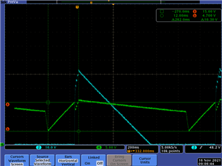

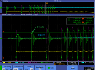

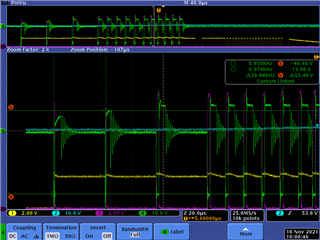

  • Hello Wesley,
    Thank you for your reply.

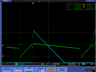

    To answer on your question, Vout and VDD are going low and below reset level.
    This sequence repeats every 1,3s.

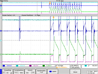

    Ch2: Vout    Ch4: VDD
    I analysed one iteration.
    First switching cycle the Vou goes to 40V.
    Device goes in sleep mode. Then every 5ms it sends some pulses that increase the Vou until 55V and the device goes in OVP.

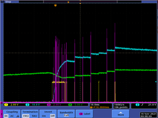

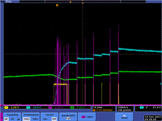

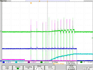

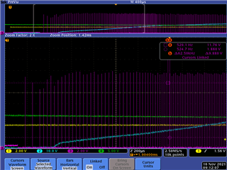

    Close up from start: First the 3 UV check pulses at 15kHz
    Image 1
    Ch1: Vsd    Ch2: Vout    Ch3: Vdriver at FET    Ch4: VDD

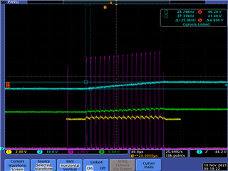

    Than several 30kHz pulses for about 1ms, Vout is inclining from 0V to 15V.

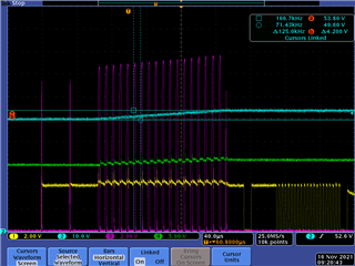

    Than freq goes up to around 60kHz (lasts 600us), untill Vout reaches 20V.
    Keeps on regulating between 15/30/60 kHz untill Vout is 40V.

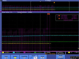

    The regulation is not in declining order.
    But some times it goes up, sometimes down in frequency.
    When Vout is reached. It stops regulating and Vsd goes to a low state.
    Device is entering powendown mode?

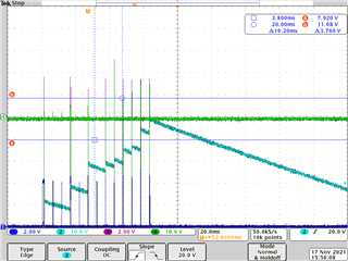

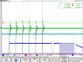

    After around 5ms it starts switching at 125kHz
    It does this several times untill Vout reaches OVP
    First the frequency is 30kHz for 2 pulses (number can vary) but then it goes to 125kHz.
    Vout goes from 50V to 54V and OVP starts working.
    I've also measured Vaux at the time of the last pulses before OVP trades in.
    My schematic
    If you need more info or measurements, please ask.

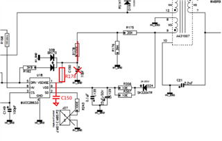

    Thanks for your sharing. I thought this phenomenon is caused by improper VS signal in this time.
    In the beginning, please move R178 and C150 to the location as below.  (the refer design is as UCC28630 EVM )
    According to the waveform you shared, the VAUX is 12V~13V around as Vout(CH2) is 50V. VS is around 6.78V~7.34V
    The VS should be equal to 7.5V to regulate the output voltage. Vaux sent a incorrect signal to VS pin to let UCC28633 increases DRV frequency.
    Would you please check the Naux/Nsec, R175 and R176 value are proper. I used the equations on page 65 in datasheet and got a briefly calculation results that R175 would be 18kohm and R176 would be 47.44kohm.  Since I have no turns information of Naux and Nsec, I assumed their value based on the waveform. So need your help to check VS setting.

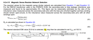

    I used the sepc. that you share and get the results as below. Would you please try this parameters first?
    R175 = 20kohm
    R176 = 50kohm
    R360 = 100mohm
    Add a Rdummy check if the phenomenon improves, based on the calculation, you may use Rdummy and starts from  15kohm .
    Wesley

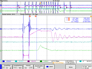

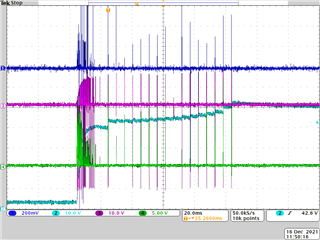

  • Hi Wesley,
    Added the values above but need to use 51k for R176.
    No improvement. It got worse.
    Ch1: Vsd    Ch2: Vout    Ch3: Vdriver at FET    Ch4: Vaux
    Zoomed in on the very first switching sequence
    With kind regards,
    Wouter

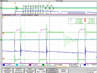

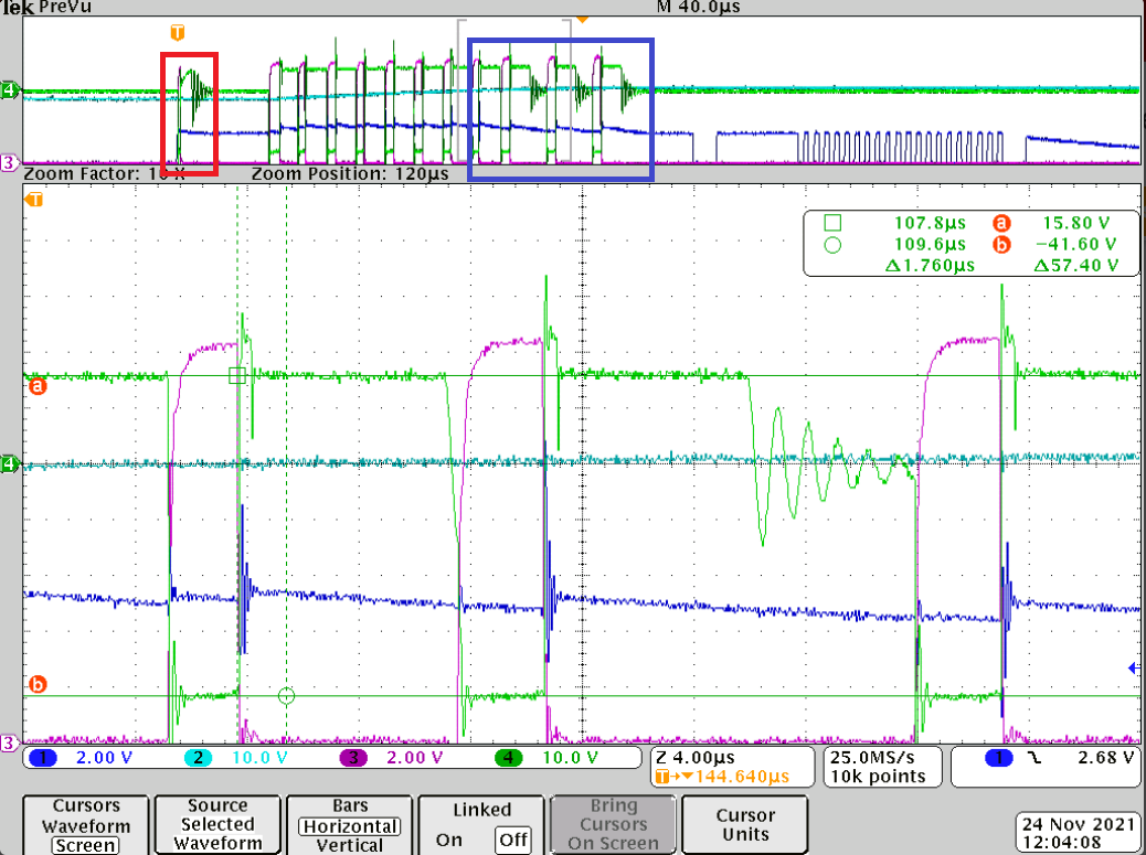

  • Hello Wesley,
    Srry for my late reply. Some other work got priority.
    I have a scope image of the last sequence before the regulator goes in OVP.
    The vertical cursor is standing 1,7us after driving the FET.
    We have a steady Vaux of 15,8V at Vout of 51V.
    Measured Sec/Aux = 3,22 or Aux/Sec = 0,309
    I also measured Vin DC = 340V. When FET is on, Vaux is -41.60V
    So measured Aux/Pri =  0,122 (comparable with the info from the manufacturer).
    With kind regards,
    Wouter

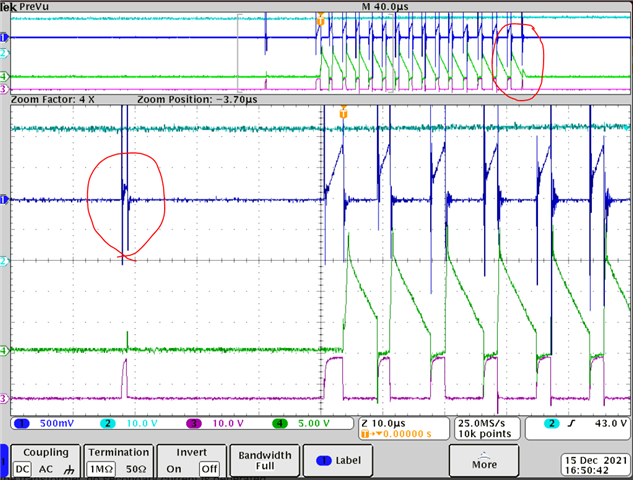

  • Hi, Wouter:

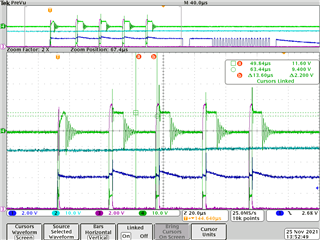

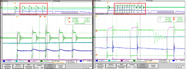

    Would you mind the check the Vaux sample point in red area? I would like to check the Vout/VDD/VAUX in this moment. It is because after the first pules, the fs increase fast. The fs decreases in blue seems correct because IC senses the the output voltage is high.
    Did you ever try to change the value of C150? Is it getting better or worse when you increase it?

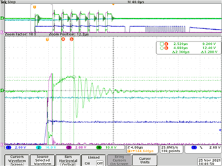

  • Hello Wesley,
    1,7us after the FET is driven, it is 9,4V.
    2,7us after the FET is driven, Vaux is 11,60V.
    For the 4 other sequences Vaux starts at 11,60V.
    Measuring the VDD gives a 14V with some smal spikes while switching.
    So that doesn't pull the Vaux low.

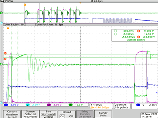

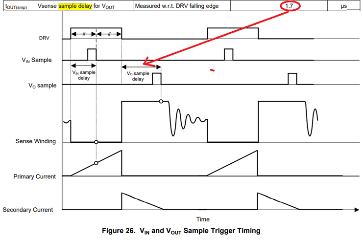

    If I understand you correctly, the switcher measures the Vaux 1,7us after driving the FET.
    It then measures a value that is to low (9,4V). Will increasing the C150 not making it worse?
    I've change the C150 to 22pF. And focussed on the first pulse.
    1,7us after the FET is driven, it is 9V.
    2us after the FET is driven (max value), Vaux is 12,60V.
    Vout is 43V
    I've change the C150 to 6,8pF. And focussed on the first pulse.
    1,7us after the FET is driven, it is 9,2V.
    2,4us after the FET is driven (max value), Vaux is 12,60V.
    Vout is 43V
    With kind regards,
    Wouter
  • Hi, Wouter
    Yes, to increase C150 should make this condition getting worse.

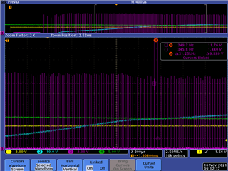

    Because I am getting confused about the waveform you shared, I would like to check if this is caused by noise.
    In the beginning, the waveform you shared as below.
    The waveform is correct. The max VDD(Green) is around 17V, which could trigger VDDOVP to shut down the IC.
    And the 2nd one shows the frequency is 200Hz (5ms), which is also correct because IC operates in sleep mode. Since this is PSR, it is needed to force switching to sense output voltage. So the output is getting higher because of the force switching every 200Hz.
    The 3rd waveform shows the fs in the burst package. As you can see the Vout(CH2) is around 40V, which is the target output. However, the fs goes to 125kHz. This frequency is too high to regulate output. So I thought there might be something wrong about VS sensing.
    The waveform also shows the similar symptom. The fs is high even the Vout is out of regulation.
    So I doubt VS could be impact by some noise. If there is a noise to make VS sensing error, it would be helpful if C150 increased.
    However, the latest waveform you shared (as the below left) seems IC operates in normal burst. It confused me because it shows the normal operation of PSR burst mode. Is the test condition different?
    Wesley

  • Hi, Wouter:
    Sorry for my late.
    The first signal is not okay since it is not stable. So IC actually read the wrong value to generate next DRV signal. but the updated time after IC sampled the Vaux value is slow.  It is a reason of the increasing value.
    To verify this assumption, would you please check if the 1st DRV width is closed to ton,min (600ns as typ).?  Please increase C149 to extend the 1st DRV width. It is helpful to let IC read the correct value.
    Wesley
  • Hello Wesley,
    Also srry for my late reply. The measured first pulsewidth is 810ns. I didn't had the time to change the capacitor.

    On this board I've measured the current in the secondary side.
    For the first pulse of 860ns, there is almost no flyback current.
    Measuring the voltage over R360 confirms this.
    Ch1: V_R360    Ch2: Vout    Ch3: Vdriver at FET    Ch4: I secondary (1V/1A)
    So the first pulse of 860ns doesn't last long enough to generate a primary current?
    Because there is no energy in the transformer, no secondary current is generated.
    Because there is no secondary current, no Vout measurement can be done.
    Is this a problem? That the Vout can't be measured due to the first pulse.
    Is this the reason that the regulation is not working?
    Are this aditional checks in this sequence of the Vout or is it only with the first pulse?
    With kind regards,
    Wouter
  • Hi, Wouter:
    Yes, I thought it would be one of the reason. So let us solve this issue first.
    The waveform of R360 seems very noisy. There is a huge overshoot and undershoot when gate on/off on the waveform. So it is hard to check if the gate turns off because of real signal or noise.
    When IC goes to sleep mode, the Vcs(limit) would be 170mV around to regulate output. So please try to increase Lpri (maybe 200uH~230uH) or decrease R360 to support more energy to secondary side after you checked the waveform on CS pin (pin3 or C149).
    About your questions, yes, IC would check the Vout not only with 1st pulse, however, the response is slow.
    (You can see it operates in CCM first and goes to DCM. It shows IC is doing the regulation but the speed is not fast)
    As you can see the gate shrink and stops after several pulse but it eventually caused Vout increase because of the slow response.
    Wesley
  • Hi Wesley,
    With the last board and 150mOhm for R360, I had a situation where it was regulating the board for short periods of time.
    I've changed the value of R360 to 75mOhm.
    The Vaux is better at the time of switch off, but not perfect.
    Ch1: V_R360    Ch2: Vout    Ch3: Vaux    Ch4: I secondary (1V/1A)
    Vaux comes up slowly, due to the low current flowing in the transformator.
    1,7us after the driver is switched off, Vaux is at the Vout level.
    So I believe a correct measurement is done.
    But now it almost immediately runs in OVP.
    But I'm starting to figure it out.
    It starts up and does his regulation until the Vout is high enough.
    Then is goes in to a mode where it reduces his regulation.
    Every 5,28ms is check's its Vout to see if extra regulation is necessary.
    By doing this check, is also drives the Vout to a slightly higher level.
    These check's continue untill Vout hits OVP.
    How can i solve this,
    so that the power going into the output is not higher then the load on the output?
    Can I increase the speed of the switcher? With less pulses, less power goes into the output.
    Increase R360? But then we have not enough power into the output so no decent measurement can
    be performed on the Vaux...
    With kind regards,
    Wouter
  • Hi, Wouter:
    Yes, IC checks Vout through auxiliary winding because it is PSR. So the concepts are
    1st, it is needed to make sure the Vaux voltage reflects output voltage correctly.
    2nd, a dummy load is needed in output side to consume the extra energy by the Vout checking behavior.
    To decrease Rcs(R360) is to increase the energy of 1st pulse to get proper Vaux, but it also delivery more energy to output side in each pules.
    Would you mind to enter the parameter that you used in the calculation file ? (UCC28633 calculator
    And then share it to me? When I inputs the parameters that you shared, it shows the Lp should be higher than 168uH.  I am not sure if my input is still aligned with your value now. You may use it to check the transformer necessary inductance and it is helpful to make us in the same page.
    Thanks.
    Wesley
  • Hello Wesley,
    I didn't use the calculator. Ive used the Ti web bench power designer.
    With input parameters:
    Input:
    AC 85 V - 265 V at 60.0 Hz
    Output:
    Isolated 40 V at 2.5 A
    It generated this schematic:
    We made a custom transformer with the specs:
    Last time I've checked, was the minimun load to add for proper regulation, 5W extra.
    The problem is, that this board needs to work for test purpose before some loads are added.
    So it needs to work with light loads ( and heavy loads (50- 60 W)
    With kind regards,
