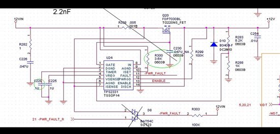

schematic, with 6mF output caps

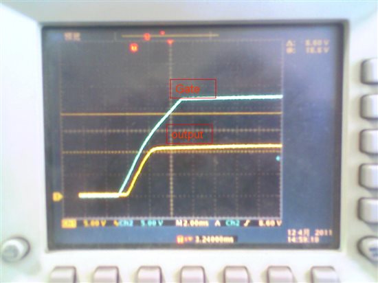

Good waveform:

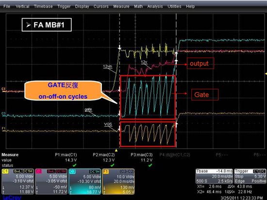

 Fail:
  • This is no retry for the TPS2331. This is abnormal behavior because of the large gate capacitance
    The text says 4.7nF but the schematic shows .047uF. The datasheet has some graphs showing gate capacitance to 10nF. If you have 47nF, it could be a problem. Check this capacitor value or try again with known components.
    If you have a 47nF capacitor, it could be that since the gate drive on this part is only 14uA typical. it doesn't have enough current to charge the large capacitor to the full gate voltage. The actual load, or voltage across the sense resistor,  is causing the gate signal to be brought low.  It looks possible in the datasheet block diagram. I'm not sure why the part restarts. It may be that the fault signal is not  generated because the timer didn't  start. The TPS2331 starts again because there is no fault.

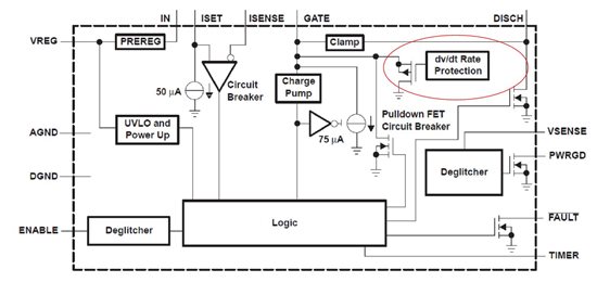

    We found there is a DV/Dt Rate Protection funciton  in blow block. What dose it mean?  How dose the IC achieve this function?
    Thanks.
    Oliver
  • The dv/dt protection block refers to a small control over rise and fall time of the gate. This is more edge control than inrush control. It is more appropriate to turn off because of the large current pull down current pulse to turn off the FET.
