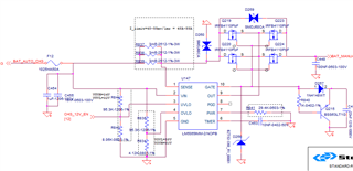

Dear friends,
           Since the PCB board has no layout space, the output capacitance is reduced to 100NF.In the process of use, the output is often interrupted and automatically shut off.
           I want to parallel 100NF capacitor in GS of MOS tube to filter out interference . Is it feasible?
           This is my schematic.
