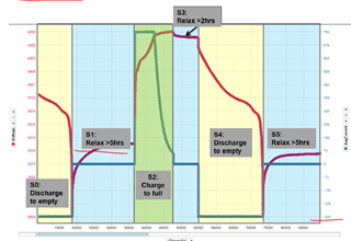

Golden Learning failed, and the customer would like to know the reason.
During S2 phase, FC set, 2 hours after static, then finds REST = 1, VOK = 0, but the Updata Status is always 0X04, no change, and no further learning is possible. (In S0 phase, GAUGE_EN = 0 disabled, 5 hours static, then GAUGE_EN = 1, S2 phase starts charging).

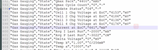

Remain the same after repeating a few times during the S0-S2 phase, looking for gg.csv, and finding that the EoC has been updated. The gg files are as follows:
