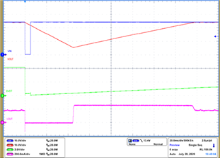

  • During supply line interruptions, the TPS2640 eFuse turns-OFF and restarts in dVdT mode which takes significant amount of time to recover the output voltage. Till that time, the load has to be supported by the buffer capacitor to meet class-A system performance.
    Let’s take an example with specifications:
    Vin = 24V
    Cout = 440 µF
    Cdvdt = 680 nF
    Rilim = 22.4 kΩ sets Current limit at 530 mA
    Load = 200 mA
    Power fail interval = 5 ms
    As you see in the below test waveform, the output voltage drops as low as 6-V due to slow restart in dVdT mode. That means the Cout has to be increased dramatically and it is just case of load current as low as 200 mA.
    Solutions:
    1. Use TPS2663 which by device architecture considers this aspect and designed with fast recovery mode of operation.
    2. To overcome this issue for TPS2640, TPS2660 devices, a series resistor can be placed in the dVdT path. When the input supply resumes back, the dVdT pin sources current IdVdT and creates an offset voltage (Idvdt*R25) at the Cdvdt pin. The offset voltage forces the eFuse to operate in current limit mode and enables quick recovery of the output voltage.
    As seen in the below test waveform, the device starts in current limit mode and quickly recovers the output voltage.
