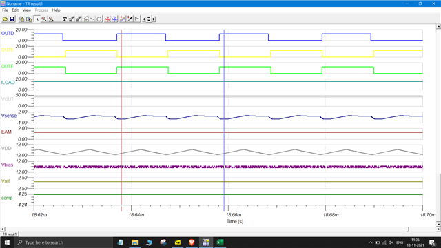

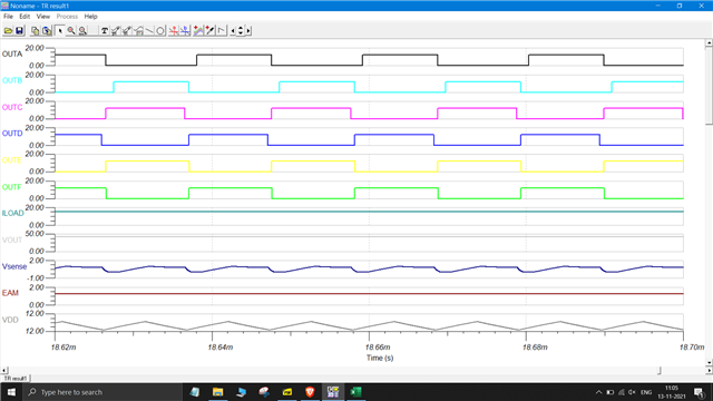

Nevertheless, I have started with the simulation of the design on TINA-TI using the component values as suggested by design note SLUC222D. However, I am not getting the desired results. Here are some of the observations I have made from the simulation
1. Vout is exactly half of the desired output voltage of 84V.
2. I had to decrease the value of the Current transformer loading resistor R1_2 from 12 Ohms to 1 Ohm, otherwise the output would drop below 10V as the Vsense value would rise above 2V (which I guess is the threshold) at which the switching cycle seems to get reduced (perhaps even terminated) resulting into lower output voltage due to reduced duty cycle. After changing the value to 1 Ohm the V_sense stays within 1V. I don't think this is the right solution as it would hamper the peak current limit for the cycle.

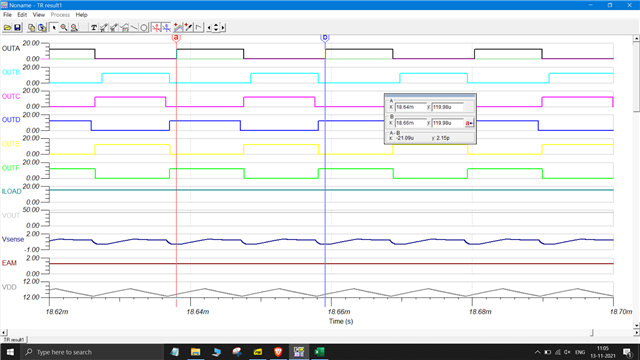

3. The period of the switching cycle is 21u sec as opposed to the desired value of 10u sec (100kHz). I have placed a 121k resistor at Rt pin as suggested by the calculations. let me know if I have made some silly error over here or not.
4. EAM is at 1.25V (as expected due to the gain of the voltage divider and the output voltage). This results in the COMP pin getting saturated at 4.25 volts. EAP is set at 2.5V. The Left and the Right leg Mosfets are overlapping at almost >80% as opposed to the suggested Dtyp of 65%.
5. Shim inductance is kept at 4uH (8uH in total considering the leakage inductance of the transformer) although calculation recommends none is needed. The turns ratio is 3:1 as suggested.

gate switching waveforms
Time period is 21u sec
Current sense voltage, EAM, EAP
    >It looks like you operating at maximum duty cycle.  This would indicate that your turns ratio is not correct.  If the voltage is exactly half you need to decrease your turns ratio by at least half.
    >If your turns ratio is 3 this would indicated the input voltage is 126 V.  The tool you have entered the input was 380 to 400 V.
    >This is mostly because the turns ratio is incorrect or the input voltage is too low.
    >The tool uses affective switching frequency.  If your primary frequency is 1/21u = 47.7 kHz,  the effective frequency is 95.4 kHz, 2X
    >This is because you are operating a  maximum duty cycle because the output voltage is not being obtained.  The duty cycle will drop to 65% if the turns ratio and minimum input voltage are correct.
    >That is O.K.
    I agree with your point that the efficiency goal has not been reached most probably due to the high values of lossy and parasitic elements. I guess selecting better switching devices and other passives along with a little compromise on efficiency might solve this issue.
    I am currently studying the datasheet as to get more details regarding what may be causing the above issue although I would highly appreciate it if you could shed some light as to what might be causing this above issue. I am not completely sure but I feel that the main transformer might not be edited well from my side, please let me know if that's the case or not.
    I am attaching the excel sheet calculation and the simulation file at the end. Any help or suggestion is highly appreciated. I will update the post if I get some new insights from the simulation.
    >I could not open the tina file but believe the input voltage is too low and/or the turns ratio is incorrect.
