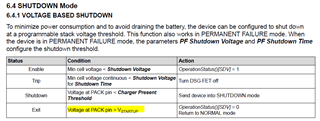

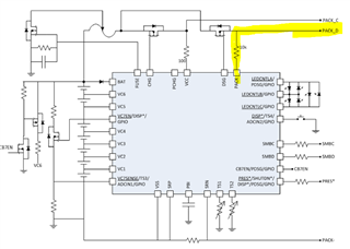

For separate CHG & DSG paths, the BQ40Z80 PACK pin is connected to PACK_D (connected to load).
How to exit from SHUTDOWN mode to NORMAL mode as PAC_D is connected to load and PACK_C is connected to charger? Cannot apply voltage to the load (PACK_D).
