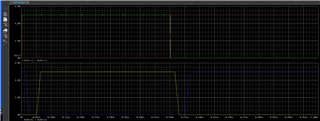

  • Hello Jimmy,
    This dead-time circuit seems okay. It is essentially the same thing as this integrated solution. I just want to share the more integrated solution in case you are interested. Here is my schematic:
    In this case, the pulses are Q & ~Q with no dead-time. I wasn't 100% on your voltage levels and frequency but this works regardless.  Also, you can buy AND gates with multiple gates in one package so think of it as one IC. This circuit works by taking the AND of the signal and a delayed version of itself (much like your discrete solution). This means that the rise time of the RC filter determines the dead-time.
    You can see that there is no dead-time between the two input signals, but both outputs have a dead-time configured by the RC filter. Let me know if you are interested in pursuing such a design, and I (or the logic team) can help you implement it. I think it will likely come down to cost/supply of buying the FETs or the IC, since they work in similar ways.
