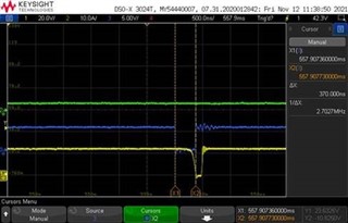

We are using the UCC27712 where the Datasheet states HI LO Off Time of typ. 45ns
Looking at our application with a HI-LO-HI time of 190ns the driver doesn’t switch off:
channel 3 PWM input: delta x = 190ns low time
channel 1 HI OUT: remains high
It requires a low-time of 370ns at the PWM input for the high-side output to switch
For a 50kHz PWM at the input we are seeing a 1kHz high side output
 (we suspect because of  the  High Side UVLO).
  • Hello Ueli,
    Thank you for supporting the UCC27712. Based on the waveforms there is a longer delay than expected but we need to confirm some details of the application circuit. Is the waveform shown for the driver input confirmed to be the signals at the driver IC input pin, Hi and COM? Can you confirm if there is an R/C filter or network on the driver inputs, and the signal shown on the plots may be the signal going into the R/C filter network.
    It also seems that the delay is longer than expected of the input falling edge to the driver output starting to fall, which makes me think there is likely some tilter delay not shown in the scope plots.
    For the second comment: for a 50kHz input we are seeing a 1kHz high side output. Can you provide more information and scope plots of this behavior? Can you show the driver input at the driver IC input pins, driver output (HO-HS with differential probe if available), and HS signals. Show at wide time base showing when the HO responds relative to the HI input. And also zoomed in time scale of when the HO responds and also on the cycles where HO is not responding.
