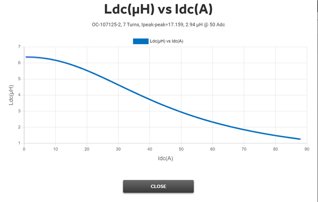

The attached design was created using the LM5155 quick start guide and uses an LM5156H (component selection is skewed heavily by parts availability).  The inductor is a micrometals OC107125-2 with 7 turns of two strands of 13AWG wire.  I attached the inductance vs current profile for the inductor.  The fet is an IPD200N15N3 with an Rdson of 16 mOhm.  I attached the transient simulation results from webench which shows the design I have should produce what are more than adequate results.  In practice, the boost converter exhibits a ~10V drop in voltage followed by a slow recovery when load steps from minimal current to 8 A.  How can I fix this problem?

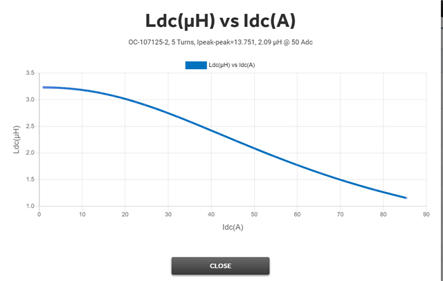

    Lout = 6uH @ 20A, 3uH @ 70A, see the newer plot attached to this post

    Same other components, inductor is two of these in series (actually two cores wrapped together):

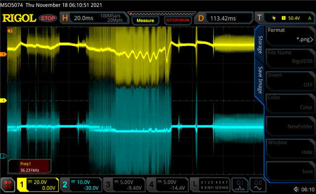

    Here is the voltage measured on the output of the converter driving a motor driver. Yellow trace is the output voltage and the blue trace is the input voltage.

  • Hello Neil,
    thanks for your reply. As first thing, I would recommend to have an RC filter on the CS pin ( like 100 ohm and 100 pF) in order to filter out spikes caused by parasitic and avoid false current limit triggering. It looks like your VIN as well is not so stable, do you have a plot of the switch node and COMP pin as well?
