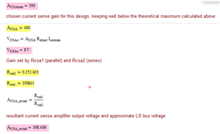

Cause need LS voltage is 8V,
From the calculation formula below, I found out why R512 value cannot use 100K
But LS voltage can be 8V when R512= 56K, why? THX
R505,R508 51 ohm
R507,R510 200ohm
R512 100k
R503 0.002 ohm
Io=10A
Acas=R512/(R508+R510)=100k/0.251k=398.4
LS=0.002*10*398.4=7.968V

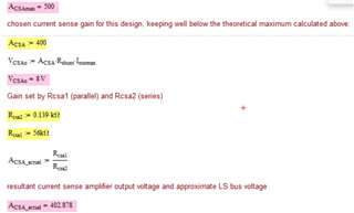

R505,R508 39 ohm
R507,R510 100ohm
R512 56k
R503 0.002 ohm
Io=10A
Acas=R512/(R508+R510)=56k/0.139k=402.87
LS=0.002*10*402.87=8.05V
