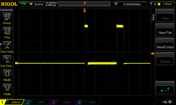

I am sorry that I didn't reply earlier, but another more prioritized task came up and I had to leave a charging issue for a moment.
I measured TS/CTRL on the oscilloscope when the device stops charging.
It looks like some attempts of communication? When the device is on the charging pad a voltage is about 4V.
