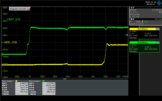

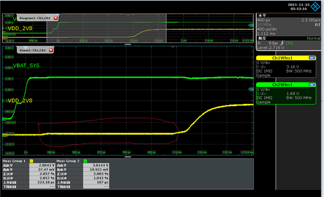

during test on TPS7A0528, we found below
Green= Vin, Yellow= Vout. Vin and EN pin are connected together.
1. there is a stage before Vout ramping up to Vset @ no load ( red circle). what's the reason for this? I see our datasheet, there is also such stage.

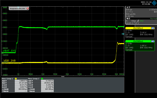

2. There is over shoot on Vout when Vout is ramping up to Vset  @ 20mA, 40mA.
Iout=40mA
Iout= 20mA
Please kindly help check the reason. Thanks.
