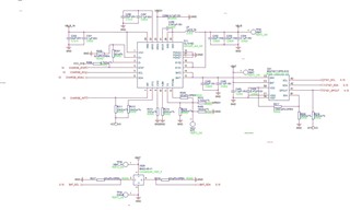

1.At present,  Six anomalies have been detected in BQ27421YZFR-G1D,After D21, the output is only about 0.4V, that is, D21 pin C3 is the battery voltage, C2 is only about 0.4V, please ask whether there is any abnormality in the schematic diagram below, and what may be the cause of the failure?

  • Please attach the schematics.
  • >the output is only about 0.4V, that is, D21 pin C3 is the battery voltage, C2 is only about 0.4V
    There's a metal layer sense resistor between C3 and C2 inside the bq27426 which is internally connected to the coulomb counter delta sigma ADC via high impedance traces. The resistance is around 10mOhm so if C3 is the battery voltage (e.g. 4V) and C2 is 0.4V then there would have to be a current of about 3.6/0.01 Ohm = 360A, which is extreme and way outside the max. operating conditions of the gauge (SRX is abs.max (=damage limits) BAT +/- 0.3V).
    So if this is indeed what you are measuring then the internal sense resistor has burned out (e.g. the abs. max. was violated in the past). The schematics don't contain enough information to say. What's the max. current between SRX and BAT1/2 from the other IC on this design? Make sure that it's less than the limits from 7.10 Integrated Sense Resistor Characteristics, –40°C to 85°C in the d/s
