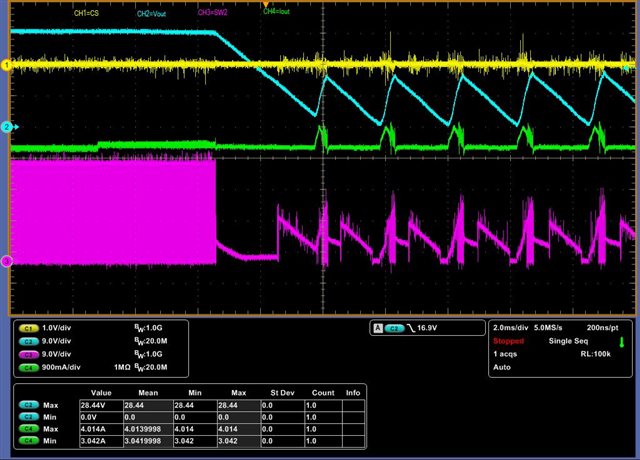

My customer would like design LM5176 and use LM5176EVM for verification first due to customer’s LM5176 on customer PCB did not OCP correctly.
Would you please review question/waveform and provide your comment?
  1. Customer change LM5176 EVM R7 from 0.004ohm to 0.002 ohm and use E-load to increase the current.
However, the OCP seems not correctly response.
Vin = 20V , Vout = 27V
 demo board OCP R7=0.004ohm
demo board OCP R7=0.002ohm

    Thanks for reaching out. What components did the customer change on the EVM other than the sense resistor? The EVM is set to 12Vout, therefore I would guess that the feedback divider and the compensation were changed as well. Is the hiccup mode protection enabled now? Do you know if the customer tested the EVM also before modifying it? Can you please kindly ask to provide the scope plots of SW nodes and the CS pin too? I'm looking forward to hearing from you.

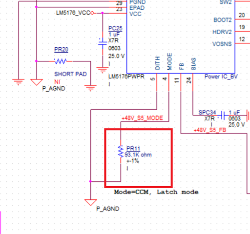

    >>customer only change R14 to make surr in boost mode.
    >>yes. (1.38V>MODE<2.22V)
    >> as below picture.
    demo board r7=0.004ohm

    Thanks for your feedback. Can you please repeat the measurements setting the bandwidth of your scope to 20 MHz for all the channels and minimising the ground loops when possible ?I would expect that a lot of noise is coming from the scope setup. I’m looking forward to your answer.

  • Hi EM,
    customer do the measurement again with 20MHz bandwidth.
    Would you please review and provide your comment?

    It seems like there is still noise in these measurements, what kind of probe has been used for these measurements? Do you know if the customer has the possibility to use the tip and barrel method?
