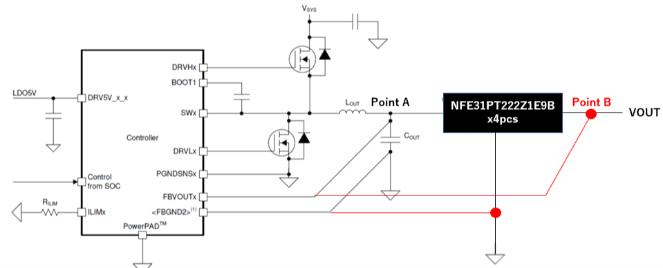

I use NFE31PT222Z1E9B(NF) to reduce noise.
Then, I would like to know the proper connection location for FBOUT pin.
Currently, FBOUT2 is connected to point A but the output voltage is lower than the target voltage.
Therefore, I would like to change the connect from point A(before NF) to point B(After NF).
Could you please let us know if you have any concern(Output oscillation etc.)?
