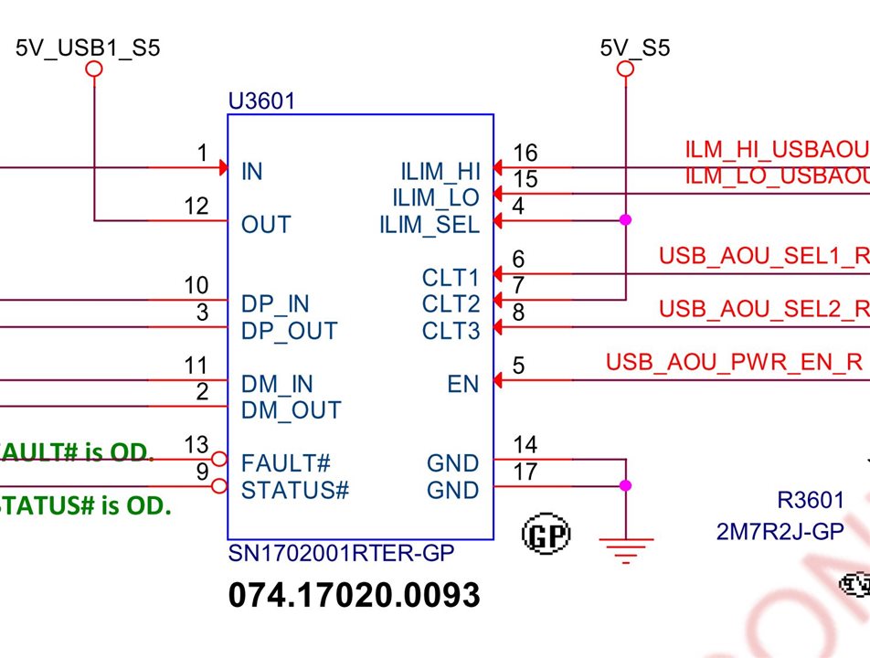

We found USB AOU behavior was correct but cannot charge in our measurement.

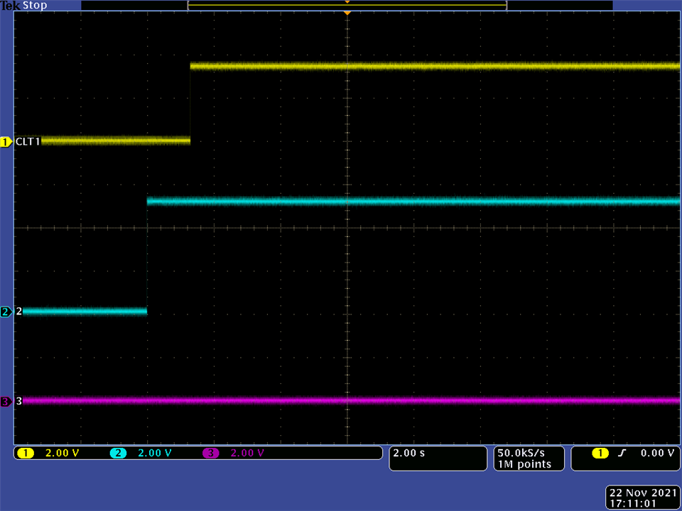

Q1: Iphone can't charge before SUT enter Lenovo logo UI after press power button to resume from S4/S5 when disable AOU. (FR: 100%)
AOU disable S5->S0, USB-A plug in iPhone
Press pwrbtn clt1, 2 to high but not charge.
No charge until you see the Lenovo logo
Q1 picture

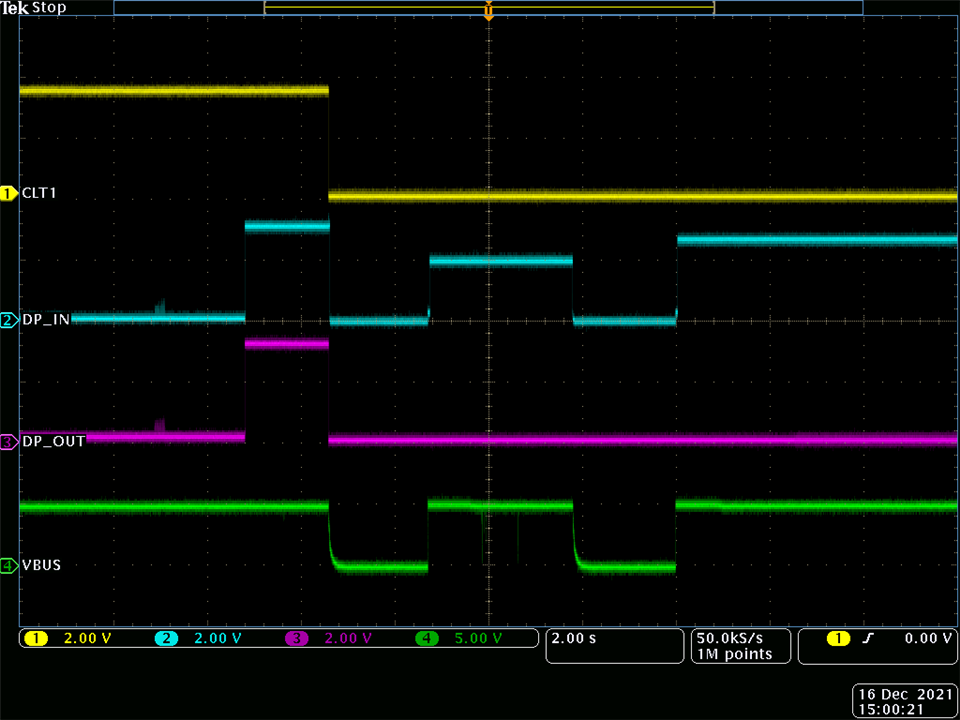

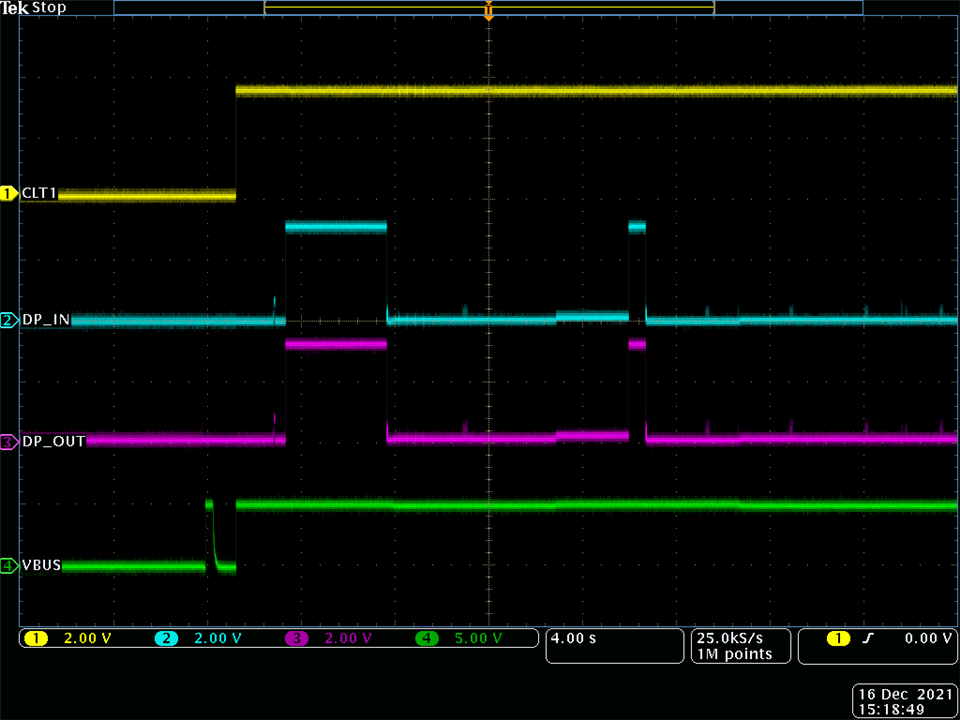

Q2: Phone charge state is discharge->charge->discharge then change to charge when SUT under S4/S5 after enable "Always on USB". (FR: 100%)
charger in battery mode enable S0->S5 USB-A plugin the android cellphone
When screen off, start discharge -> charge -> discharge -> charge
Then the fan stopped and clt1 to low.
