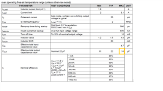

The maximum output capacitance of buck6 is 33uF, can it be changed to 47uF? SND9039A's Buck6 (1.8V) will have a power failure problem when the temperature is below 0 degrees. It has been tested and confirmed that the output capacitor can be increased to 47Uf and it can work normally without power failure.
