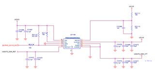

Hi team,
Could you kindly check 51200 SCH?
Amelie,
C31069 can be reduced from 1uF to 1uF. Additionally, C31070 can also be removed.
While not necessary, an additional cap can be DNP between VO and GND in the event that it needs to be populated.
