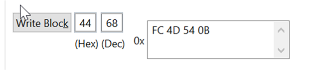

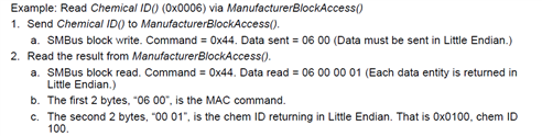

Hi
Can you confirm if the following is correct from the BQ40Z50 Technical reference.
From looking at a logic analyzer trace when using bqStudio with the Bq40Z50 evaluation board an extra byte is sent between 0x44 and data sent/ data read, the extra byte is the number of bytes in data sent/data read.
From what I can see(and please correct me if I'm wrong)  this information is missing from the technical reference manual see analyzer trace below of sending chemical ID command to bq40z50.
Ian
