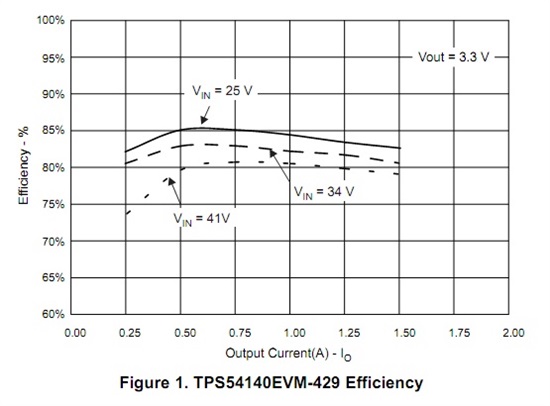

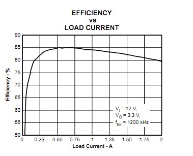

Hi;I am looking for a psu which can give 2A peak current.I have chosen TPS54140.On datasheet a graph( grap) named efficiency vs load current says that max 2a load current is possible (at 1200kHz ).But on EVM datasheet (500Hz) it is given that max 1.5A is possible on Figure 1
My question is :Is there a relationship between switching frequency and efficiency (or max load current)?
  • No, there is no direct relationship between output current and switching frequency.  As switching frequency goes up, there is less ripple current in the inductor which reduces the peak currents in the inductor.  The peak current is what is monitored in the current limiting circuitry.  So, as the ripple current decreases, the peak current will go down and you will be able to get slightly more output current before hitting current limit.  But, most of the time, the ripple current is a percentage of the output current, and from this percentage the inductance is chosen.  So, usually, for higher switching frequencies, the inductance is less which results in the same amount of ripple current.
    There is a relationship between switching frequency and efficiency.  As switching frequency goes up, the switching losses in the FETs and their drivers increase and so efficiency goes down.
    The TPS54140 is a nominal 1.5A part.  This is based on its current limit specification of 1.8A minimum and 2.7A typical.  The minimum specification drives the output current rating for the IC.  So, a typical IC could deliver 2A of output current but no IC could be guaranteed to deliver that much as it is above the 1.8A minimum spec.
    If you need a 2A supply, you should go to the TPS54240.
