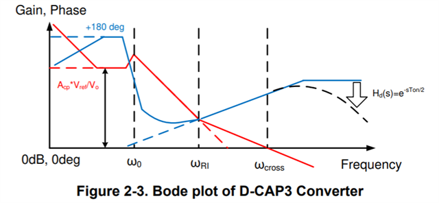

TPS548A28: DCAP3 DC gain
Part Number: TPS548A28
I know DCAP3 introduce extra zero and pole and low frequency to increase DC gain,
unlike DCAP2 has Acp, how can I measure or calculate the DC gain as well as the extra pole zero in DCAP3  , it's not mentioned in the datasheet either
