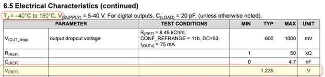

Hi
Can you provide Vref min. and max. value ?
Datasheet only list typical value.

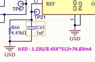

Hi Ben
Below are example that customer may consider
Ex: as below circuit, if the resistor R66 got -3% error
ILED: 1.235 / (8.45*0.97) * 512 = 77.145mA. In this case they need to know the Vref max value to calculate will the final current will go outside the recommend ranage.
Hi PY,
To calculate the worst case accuracy, the ΔI(out_d2d) spec in the datasheet should be used. This already includes the inaccuracies of V(REF), K(REF), and channel output current DAC. The only factor not included in this spec is the reference resistor accuracy. The total accuracy can then be calculated by the square root of the squared sum of both accuracies, e.g.:
√((3%)2+(5%)2)=5.8%
