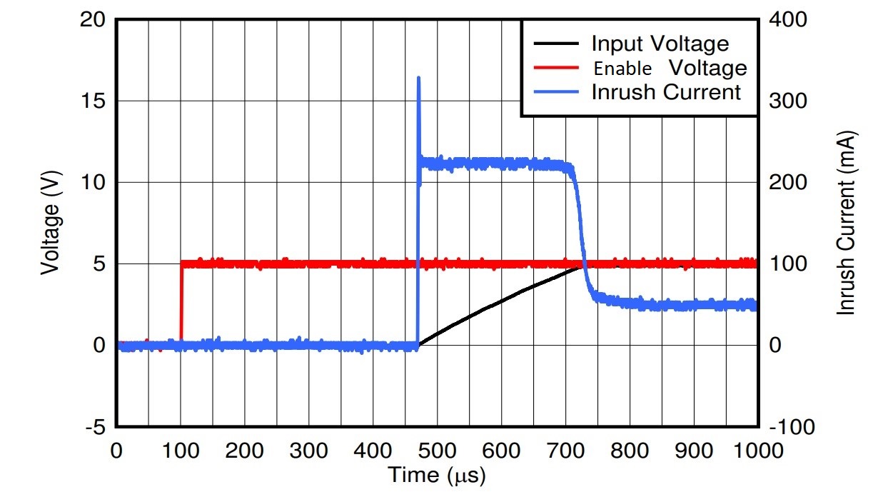

  • Hi John,
    Let me confirm one thing on behalf of Kazuho.
    Inrush current of customer's circuit can be as high as 600mA, based on your answer I think it won't cause problem, am I correct?
    Thanks.
    Jo
  • Hi Jo,
    What will occur is the inrush current will spike up, then current limit will come in and it will settle at the current limit of 400mA, before beginning standard regulation. The profile of this current shape will look similar to the following showing off the three phases of the inrush current. The current limit will protect the device so that it is not destroyed in normal operation. The LDO will not have any problems from this operation, no.
